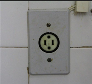

  • Whatever the official standard socket is in Brazil, in practice when you get way from the tourist hotels built in the last decade or so, you will find round 2 pin sockets that are more or less the European spacing, but with thinner pins. You will also find  a metricated rounded up  USA flat blade kind as well, both types on both voltages.  From what I understand  from relatives who have been to Argentina and Paraguay  those parts of  south America are much  the same, though perhaps more 110v and flat blade plugs as you get nearer North America.
    here is a  picture of the 'universal' house socket as seen in domestic kitchens and bathrooms.
    The idea is that the flat receptacles may be connected to 110, and the round holes to 220. This sounds like an excellent idea, but in reality as only one voltage or the other is ever supplied, we may find that both are 220, or both are 110, or that one half or the other left is left disconnected.
    The only good news is that the 4mm round holes do not take the earth of the 3 pin US socket, as if they did, there would be a 50% chance of a live chassis. As it is, that troublesome pin gets snipped off, which may be safer in some cases. Dont ask about the wires that are, I think, a power take off to a switch for an extractor fan.
    In many ways the new socket is a much better idea, but it will be 50 years before everyone has one, and the voltage confusion and plugs that look the same is just silly.

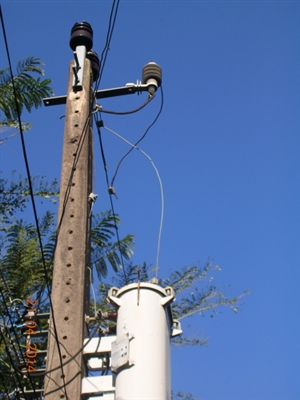

  • Well possibly Chris, the 220V friends of the family we stayed at are in Florianópolis, and their holiday home is on the mainland, and ag with one neighbouring property it is on the end of it's very own  branch supply in  MRT (Monofásicos com Retorno pela Terra  ==  single wire earth return) - the transformer and associated one street lamp up the precast concrete pole outside looks very strange to my UK eyes  with just one HV bush on the transformer and the  one 19kV line coming in at the top. That  building was regarded as 'new' and I think would date from about 2010. Not a 3 pin anything in sight, but as the incoming mains had no earth, no electrodes and no RCD, that would have been fairly pointless anyway.

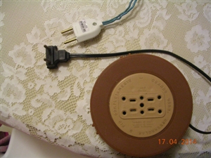

    An extension lead with another design of universal socket that takes both flats and rounds.
