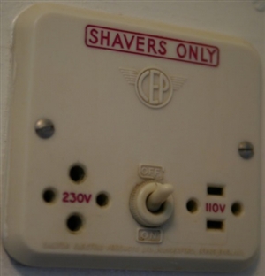

  • An old shaver socket from the 1970s. The 230V outlet has holes for both BS4573 and type C plugs. The 110V outlet has holes for both type A flat pin and (type C?) round pin plugs.
    Did any countries in Europe have 100V to 120V mains supplies with sockets that accommodated a type C plug back in the 1970s?

  • That's interesting about Luxembourge having 127 volts in the 1983 edition of the WRTH it's listed as 110/190 volts I wonder were they got that from? Also some parts of Vienna were on 127/220 at that time too
  • It raises the question, after factoring out Brazil, whether the facility for the 115V outlet to accommodate a type C plug with round pins in modern day shaver sockets verges on an anachronism from the time when Europe had 110V or 127V mains supplies? The number of shavers from that time with a type C plug that requires the 115V outlet still in use today must be miniscule.
    It's possible that the situation in Brazil where a type C plug fits a type N socket on a 127V mains supply is a coincidence rather than a compelling reason for the manufacturers of shaver sockets to continue to offer the facility for the 115V outlet to accommodate a type C plug, and the manufacturers might not even be aware of it.
  • I would not buy one that could not take type C plugs in the 115v socket for reasons about the poor regulation I mentioned earlier.In fact I don't buy MK ones either as although they can take type C plugs in the 115v side they cannot tale UK shaver plugs there.
