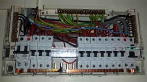

    There's around fifty of these consumer units on a local Housing Association estate.
    Andy Betteridge
  • Apart from the bad dentistry on the LH bus bar, that sort of thing is pretty much exactly what I was thinking of. Hopefully a bit less ram jam - how many
    socket circuits and what are the rest  cooker, shower, ring,  water heater dunno, dunno, lights. and then 2 storage heaters and a storage supply for water ?
    However I'm drawn to the Wylex neutral breaking RCBOS, for the compact size and neutral breaking, I think crabtree are similar, but not Hagar as far as I know ?
    it is our place so no chint or other super cheap...  double pole bus bar is neater. Shame I have not heard of anyone using them
    Those in that pic look like MEM's floppy plastic phase, I hope not.
