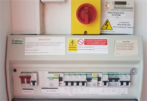

How and why?
I did not take the cover off to have a look inside,  so I am still wondering how and why?
Andy B.
  • The screw ? I imagine the plastic pillar/ boss  that the original screw went into has failed (split.snapped) and the replacement simply goes right thrrough into the wall behind, and the washer covers the damaged plastic.
    May need some care re-fitting not to snag the internal wiring, which I bet without seeing it, combines the best of spaghetti and violin strings.
  • Try again
    It is something I won’t ever know the answer to, because I didn’t take the cover off to have a closer look.
    Andy B.
  • I'm curious as to how they got the downstairs ring, the upstairs ring, the water heater and the security alarm (burglar alarm?) all on one CB. (Not to mention why it doesn't keep tripping)
    Alasdair
  • Wait to you see it when someone tries to squeeze in two EV charge points!
  • What is the particular feature of Crabtree consumer units?
    Andy B.
  • lyledunn:
    I think Lyle has spotted it.
  • Wylex MCB (which are non plug-in Busbar fitment) in a Crabtree busbar fitment board??
  • Dbat:
    Precisely, how and why?
    Andy B
  • "How and why?" indicates a misunderstanding of the ingenuity of complete and utter idiots. Sparking Chip I`m sure you`ve witnessed as many idiots as I have and therefore your question is rhetorical
  • It would be interesting to know how they had converted the mcb to one that will “plug in” to the Crabtree busbar system.
    Regards,
    Alan.
