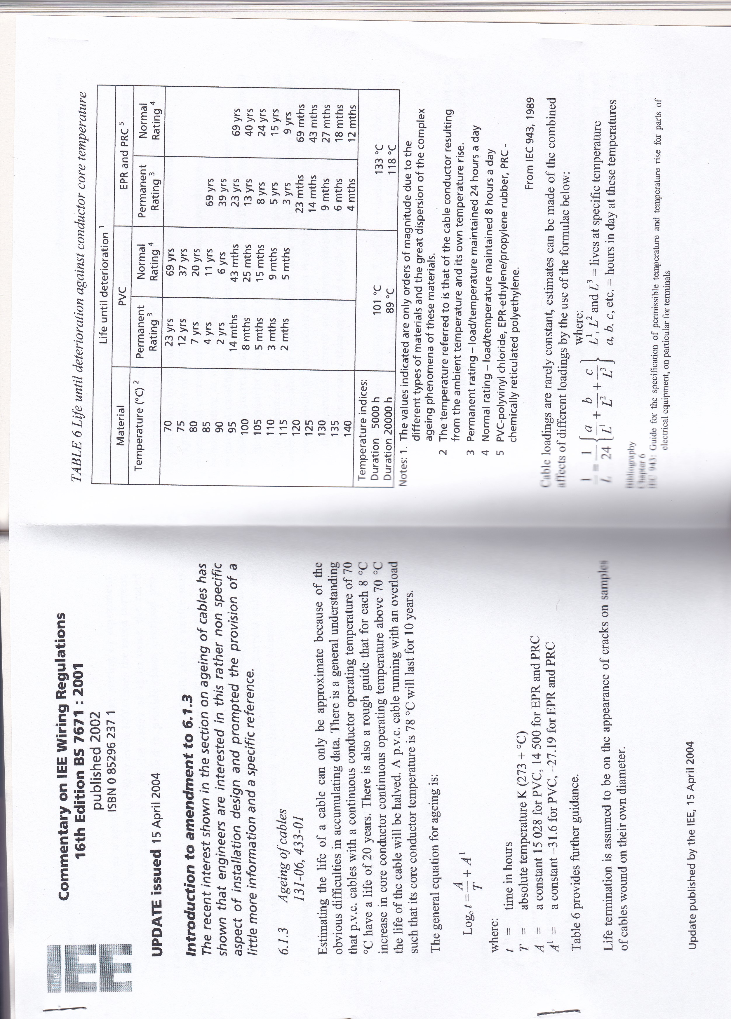

Long shot - anyone have a copy of the WireRegs/Commentary-UpdateApr04.pdf
Until a couple of years ago the IET published a 'commentry' that described some tests of cable ageing with over temperature and has formuae for estimated the life shortening effect of  overloading.
The URL used to be
https://www.theiet.org/Publish/WireRegs/Commentary-UpdateApr04.pdf
Sadly the webpage has moved as part of one of the tidy-ups, and for whatever reason the Wayback machine never archived it. Before I pester the webmasters on Monday if they have it on back-up tapes I'd like to ask on the off chance if anyone happens to have kept a copy they could upload ?

  • This sort of consideration Mike?
    "Has some tables that suggest that at full all day loading, to a 70 degree core temp, one might expect a 23 year life before the plastic cracks and loses its integrity.
    I suspect that much more realistic is full load for 8 hours a day (69 hour life) or even operation at at less than 70 degree core temp (most domestic lighting circuits for example a very under-run) and then one has a doubling in life time for every 6 or 7 degrees, mind you for PVC it is all based on extrapolation from a test 5000 hour life at 101 degrees, and 20000 hour life at 89 degrees. I suspect that local instalation details (like 'exposed to sunshine', or as norman has pointed out, 'touching heating pipes' will be dominant in many parts of a real installation.)
    I expect many well done installtions to outlast the building on that basis.. (average building life in the UK is a few hundred years at present, but that number is not real, and is is only becasuse we are currently building faster than we are demolishing..)"

  • Hi Mike. Our head of technical regulations says:
    Information on aging of cables can be found in “Commentary on IET Wiring Regulations 17th Edition (BS 7671:2008+A3:2015 Requirements for Electrical Installations), 7th Edition”. This publication was not updated to BS 7671:2018 but the information on aging of cables, page 104, clause 6.1.3, remains current; available here:
    https://shop.theiet.org/commentary-on-the-iet-wiring-regulations-bs-7671-2008-2015
    Mark Coles
    Head of Technical Regulations
    The IET
    Hope that helps!
  • Thank you for that - I have now been shown a copy of the book version, which looks to have the same technical content as the web article that has been moved,  just some different introduction to what I recall and re-pagination.
    I suspect the web article was intended to be an explanation of what is in the new book'  `and at the time it was new.

  • Back when we printed out amendments and stuck them in our books, I found the original PDF printed out and stapled into my old copy of Commentary on IEE Wiring Regs 16th Edition BS7671: 2001.
    See file attachment below
  • Alcomax:
