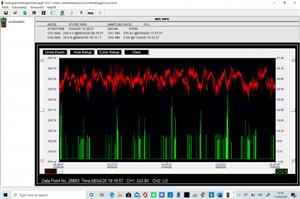

    The data logger doesn’t record below 10 amps, when it was doing the record in the photo above there was 1.69 amps being drawn by timers, etc including Bod’s hated parasitic USB charging sockets, but the graph is a flat line.
    I will be surprised if the current drawn breaks the flat line many times in a week as we don’t have any electric heating.
    Acknowledged Andy! I did wonder if it would have the ability to record mA leakage if clamped over the "meter tails" or an individual circuit but you've answered that. I don't fancy the idea of multiple turns of meter tails through the clamp to increase current detection!
    Apparently it does record below 10 amps, but not all the way down to zero.
    So during a week of the Corona Virus lockdown it appears I have a record of electrical events that comprise of boiling the kettle to make tea and coffee, using the washing machine and dishwasher, cooking and using other general domestic appliances.
    No surprises, but I still expect that if I applied to have an EV charger upgrading the supply from a looped 80 amp supply would have to be discussed.
