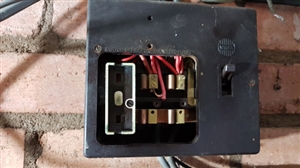

    No tools required, I removed the cover and the fuse carriers with my fingers.
    Spot the cooker circuit that supplies the 2.8 kW double oven in the kitchen, it's in there if you look carefully.
     I have actually pulled the perished rubber insulated cable out.
    A job for the morning.
