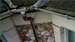

  • I have One of these in the back of my van.
    It is better than dying trying to get a test result for an EICR, as has happened.
    I can also put my Ferret camera on the end on it and check the gutters, as I did last week trying to work out what can be done about the damp in a HMO.
     Andy Betteridge
    It takes inspections to a whole new level, literally!
