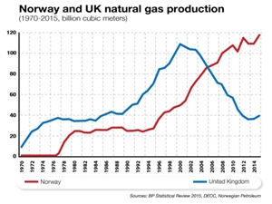

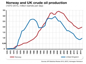

    Please explain how you can avoid the price of gas rising, when it has been practically pouring out of the north sea for free for the last half century, and now it is having to be brought in from further and further afield. No conspiracy, we have just spent up the great dividend of having nearly free energy, and in future it will not be, we seem to be surprised a higher fuel bill.
    Graphs from that most pro fossil fuel source, BP...
