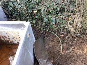

That’s a 25mm2 earthing conductor run some 20m along a border hedge to an electrode at the rear of the building. It is a permanent, recent installation. When I commented on it the contractor lost his cool and screamed “what the hell is wrong with it”? I thought that the answer was obvious but my written response on behalf of the client is to be framed within the context of 7671. I have no difficulty in digging up the relevant regulations but they are subjective in nature. Anyway, all good fun!

  • You say it goes to an earth rod? I wonder why its 25mm? It would be interested to measure the earth resistance of that installation. I assume it is TT?
    I don't think this is a professional job and so some DIYer has not quite got the idea of Earthing right. I cannot think why anyone would do that unless the building is on a big rock and the rod cannot be driven elsewhere, which is possible. I do see why the cable is not buried however, that is the rock! Would it be satisfactory if laced with a warning tape? I wonder if any of you have ever got a big digger with breaker and tried to bury cables across rock, it is not easy and very expensive! I don't think my hedge trimmer could cut a 25mm cable, it has trouble with some branches of 8mm or so.

    eventually found the rod below a discarded water tank at the rear of the building. The DNO earthing arrangement was lost and after six months of waiting for a fix, the client decided to engage a contractor to convert to TT. His EIC shows a Ze and Ra of 0.26 but was 127 when I measured it. The reason for the long run is unclear but there were definitely easier alternatives. I originally thought that the fix was temporary until the DNO got their act together but that is not the case.
  • Might have been better to bury and earth the old water tank.
    I have seen the reverse, maybe the prize for the shortest cable to a rod, the head of the rod being inside the building, under suspended floor, driven out at about 45 degrees though the footings via a hole in the bricks below the DPC.
    If the intention  of the job was it only had to last until the DNO came back,  and the intention was later to coil it in and take it away later, maybe.
    It does beg the question of why you want to use a potential that could be a few volts different to the earth the house is actually standing on. (only in a built up area with PME)
    Stealth VLF comms antennas can be made this way, but I'm very sure it is not that.
    Is the rest of the TT OK? - RCDs and all that.
    I wonder if the installer considered that it'll become buried in time and so applied table 54.1 - 25mm² copper supposedly being adequate against both mechanical damage and corrosion.
    That said, my hedge trimmer will happily cut through broom-handle sized branches - so doubt a few mm of annealed copper will stop it - and my loppers would certainly make short work of it - so given it isn't actually buried...
