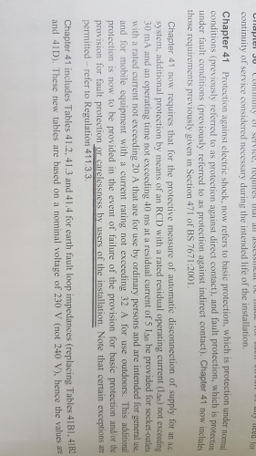

    The introduction to BS 7671:2008.
    I have underlined a pertinent point, we have supposedly been protecting users of electrical sockets in domestic properties from their own carelessness for twelve years.
    Yet people are still indecisive about coding a socket outlet for  an EICR. How many years does it take for a Wiring Regulation to become generally accepted?
    Andy Betteridge
