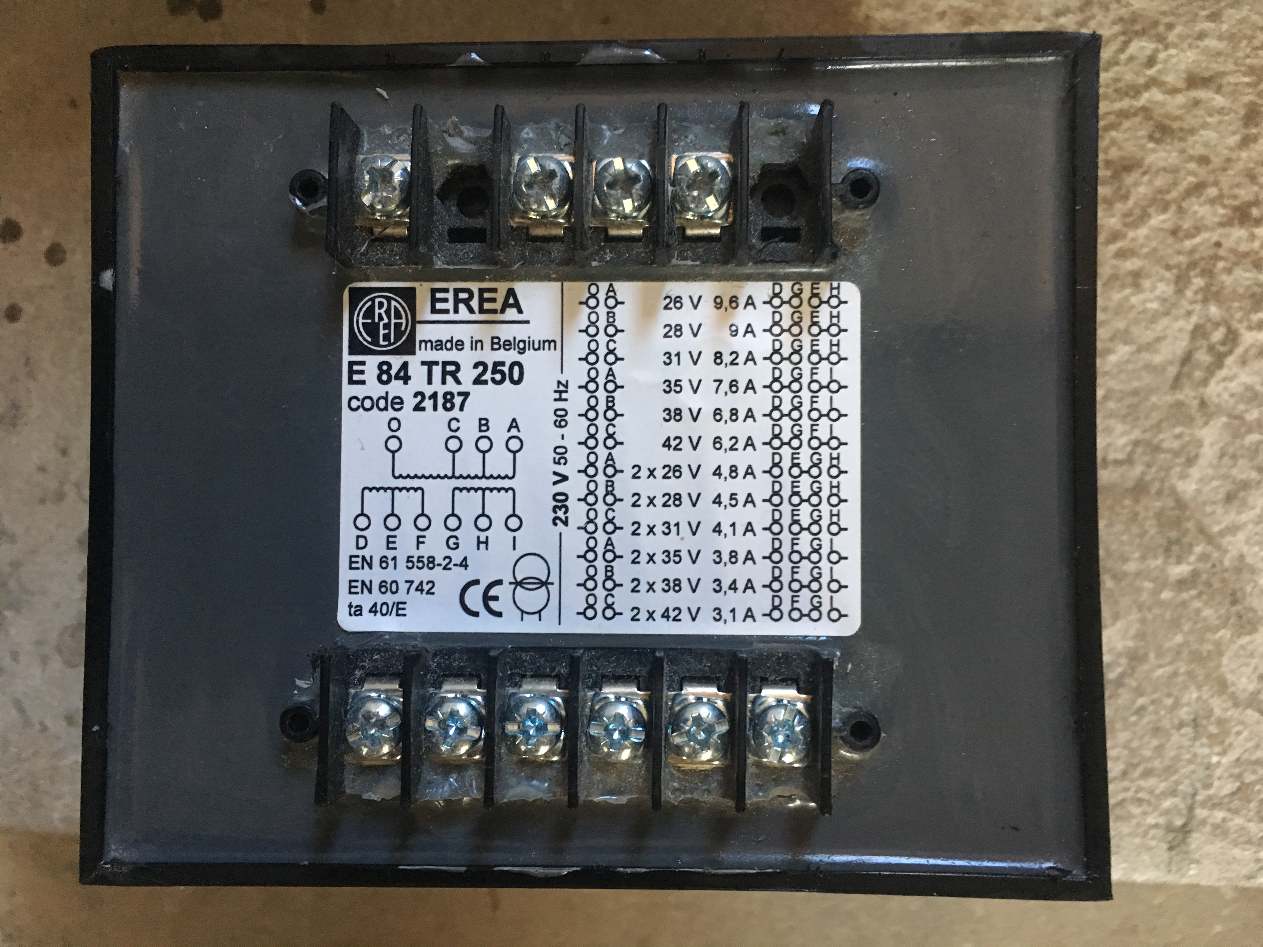

    I think a photo of the transformer may help, and late, assuming it can be set for 1 phase then perhaps carefully powering it on and looking at the output voltage on the secondary terminals with a meter before connecting any windows.

    I've attached a pic of the transformer that was sent - never been wired up. Hope it is of some help.
