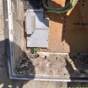

  • The DNO have installed their network rod from their intake in the plastic meter cabinet on the exterior of farm building, as is common practice in rural locations where the transformer serves supplies one consumers installation and that is where the DNO neutral earth link is not at the transformer.
    I have not suggested interfering with the DNO equipment and I am certainly not stupid enough to break the seals on the DNO and remove the cable and transformer earth connection, merely not using the earth terminal supplied by the DNO for use by the consumer to use at the consumers own risk.

    Andy, thank you my MISTAKE! I hadn't looked at the picture properly. ?
    So the DNO's rod is the source earth which has been placed in accordance with R.8(3)(b) of ESQCR 2002. It must stay as it is.
    The system is PNB. I must say that it would be helpful if it got a mention in BS 7671, but it doesn't.

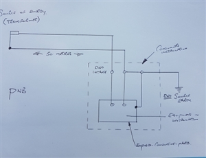

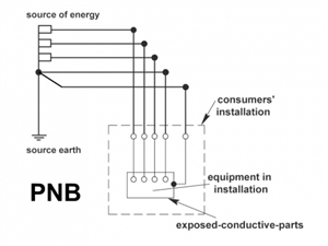

    So here is Fig 3.8 (TN-S) with the superfluous bits removed and the two nodes at the extreme left combined into one. If I understand the description correctly, this is the same as the supply to the farm.
    So this now leaves two questions:
    (1) How far apart are the DNO's source earth and the TT earth?
    (2) Why was the farm building converted to TT?
    I share the opinions that the farm building should have only one earthing system, be it TT or TN.
  • Most of that diagram can be stripped away
    Assuming it is Protective Neutral Bonding, there isn't a PEN conductor or a seperate earth conductor in the DNO cable, the neutral link, source earth conductor and the consumer  installation earth conductor are all connected into the same terminal block in the intake in the meter cabinet on the outside wall of the farm buildings.
    This set up is really as simple as it can get without an frills or gizmos.
    Andy Betteridge
