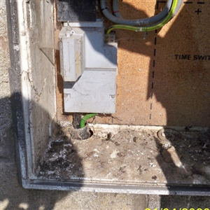

Some years ago I started doing electrical work at a farm, originally the farm buildings and house were both connected to the DNO earth terminal.
I altered it so that the farm buildings are TT , but left the house connected to the DNO earth terminal. The possible issues are that there is a steel clad switch fuse enclosure for the house inside a wooden cupboard in the farm workshop and the SWA cable for the house passes through the ground immediately adjacent to the farm building. But there was no physical connection between the house and farm earthing arrangements.
It had been like that for a few years as the house has not had any alterations at all, just a few repairs. So the house installation is effectively exactly the same as it was when the house and the farm buildings were thirty years ago and connected up as a new installation by the DNO.
However (you knew there was going to be a however!) a couple of years ago PV panels were installed on the farm building roof and the installers used the DNO and house earth terminal rather than the farm buildings earth terminal, despite the PV system being in and on the farm buildings and it having storage batteries that feed back into the both installations as they share a meter; and the storage batteries act as a supply to emergency lighting in the farm buildings when the installation is off-grid.

  • A WPD engineer phoned this morning and said they don't have records for this property, so he drove there this afternoon to check it out.
    He has declared it as a TN-C-s PME system, so any ideas of reconnecting the farm buildings to the DNO earth terminal have been blown away and I need to disconnect the PV installation earth conductor from the DNO earth and drop it into the farm buildings TT MET after I have checked the PV consumer unit out.
    There wasn't an opinion offered on what to do with the house one way or the other.
    Having declared TN-S was maybe a bit of a long shot, but would have made life easier, but the fix isn't too complicated.
    Andy Betteridge
  • He has declared it as a TN-C-s PME system, so any ideas of reconnecting the farm buildings to the DNO earth terminal have been blown away and I need to disconnect the PV installation earth conductor from the DNO earth and drop it into the farm buildings TT MET after I have checked the PV consumer unit out.
