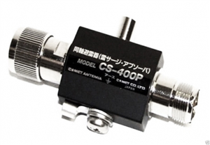

    I have one of the devices like the one below (not the exact same one) but looks like it needs an earth connection as well, so I might just put it in an IP65 enclosure outdoors and earth to a rod and bring the coax inside.
    What do you think about this? Do I really need to earth the coax surge protection device (that is what the small screw is for).
    What is my risk profile if i just say sod this all, bring the coax in and run off the mains PME earth but just be careful anytime the weather is off?

    You do not need the earth for propagation as you aerial is a near balanced impedance on the end of the co-ax.  Lightning protection, if required is a different matter. The usual method is to have a spark gap or surge protection outside near the ground connected to an earth electrode which is back to the question of the earth electrode.
