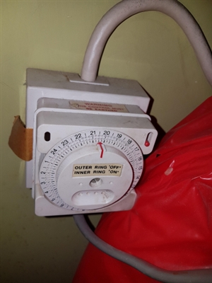

  • I need to go and sit at my desk and prepare a quote, earlier this week I went to a flat which is electrically heated with an E7 prepayment meter to work out how to reduce the electric bill, which I think can be reduced by at least thirty five quid a week over the winter.
    On the list is replace this useless timer.
    Andy B
  • Sparkingchip:
    Andy B
    I expect that the timer is o.k. but is just lacking some pins.
