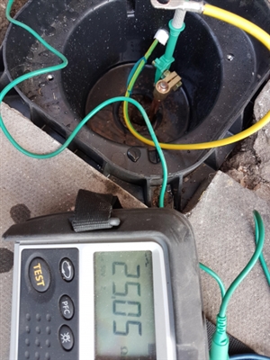

    I tried watering a 3.6 metre rod I had knocked in, it went from 27.69 ohms to 25.05 ohms after having a hose pipe on it until the pit flooded.
    So that is three sections of rods and wet, one section on it own was 584 ohms.
    Depth makes more difference than water.
    Andy
  • Sparkingchip:
    Not if the deepest part is saturated. Adding water would not be expected to change things to any great extent.

  • 25.05 ohms after having a hose pipe on it until the pit flooded.
    Andy
    That will be one of those where the text book simplifying assumption the ground conductivity is uniform is clearly so untrue as to be utterly risable. I imagine if you were to dig a trench you would see clear strata of different materials and varying moisture  content, with something deeper down that is much more conductive covered by an almost insulating skin. Is the top soil light and sandy or very pebbly by chance,  sitting on clay ?

  • With increased depth a rod gains length and surface area, as well as the depth, which is more beneficial than temporary solutions such as a bucket of water.
    Andy Betteridge.
