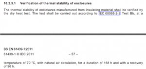

Was talking to a switchboard manufacturer and he mentioned that the switchboards manufactured to BS 61439 are only tested to 70 degrees C, so all the cables attached to/from it must be calculated for 70 degrees. The only reference in the standard which makes some sense about this is section 10.2.3.1 attached. This means that all the XLPE cabling out there which is rated at 90 degrees is under-utilised and is useless.
Many designers I assume, are not aware and proceed in producing the calculations in Amtech or similar with cables to set operate at 90 degrees and think all is ok.
    I think you may be mixing up 70C with what is actually a temperature rise of 70K above the ambient. The switchboard should not allow the terminals for external conductors to exceed a 70K rise above 20C - ie 90C. Busbars etc can rise to as high as 105C.
    The manufacturer is of course at liberty to state a temperature rise less than this for the device to deliver FLC  - but I'm pretty certain Schneider don't do this as their ACB's and MCCB are widely used in third party switchgear.

  • I did some googling on their website and found the below. Two of their specification engineers also agree that they quote the switchboards to be only permitted to accept 70 degree cables. As far as the standard they are manufactured to, is not very clear about this 70 degree property. Could not find any reference to that apart from that section talking about testing.
