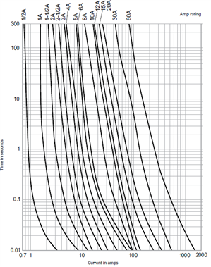

  • Good shout. I do plan to use cut-outs also for local isolation/maintenance which i didn`t make clear at the start. I have looked at DP Tofco Cut Outs (Other manufacturers are available) located in each Lighting Column comprising individual 6A fuses to BS88-2. The problem is that the 6A fuses according to BS7671 Time current curves table Fig 3A (3 a) states they will withstand up to 36A up to a maximum of 0.1 second. Next size up fuse is 20A BS88-2 which will withstand 180A for 0.1 second. A 20A device means i lose the discrimination/selectivity. If i up the over current device protecting each circuit from 10A to 20A to keep selectivity compliant then the cables to the Lighting Columns become very large feeding each cut out ie from 6mm SWA to 16mm due to VD so not ideal and costly -  if that makes sense.
  • Here is the curve chart

  • Great shouts. This might be the answer, just found that the BS88-2 (Bussman as an example) make a 10A version which shows can withstand up to 60A up to 0.1 secs. This should hold 57A spike per Column.

    Probably worth pointing out that the inrush current, whilst reasonably large, is also very short lived - the manufacturers data probably says it's something like 57A but that is only likely to exist for about 150 microseconds - ie about 0.00015 seconds.
    This is so short as to make time current curves almost useless, you need another approach such as:
    Wire the circuit to your proposed column groups (7No) in say 6.00mm2 and protect with a 63A fuse (you aren't worried about overload protection at this point - only short circuit and inrush protection)
    Put a 10A fuse in the cut out assembly to manage the inrush of the single lamp and to act in concert with the other columns for overload protection of the circuit (you are assuming here that you won't get the same overload fault on every column simultaneously)
    You could run a 3 phase circuit around every column to 3 phase cut outs with the luminaire connected on the relevant phase to the cut out (or as Alan suggested, loop a single phase circuit and use 3 circuits)
    In practice, the very short duration of inrush at 0.001 seconds as a very conservative upper bound, won't ever trouble a MCB which usually has a minimum time to operate of around 0.01 seconds (ie 10 times longer) - consequently you are very unlikely to delatch an MCB - but fuse technology in this application is preferable

    In terms of your 6A Type C, then that has an instantaneous trip of 6 x 5 = 36A, allowing for a crest factor of say 1.404 = 50.5A - so that's still shy of the theoretical inrush of 57A
