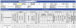

I am reviewing an EICR recently issued for a building with several Distribution Boards feeding sub-Distribution Boards.
I have noted that in some instances, the figure recorded for 'Zs at this board' is significantly less than the Maximum Measured Zs for the circuit recorded on the feeding DB.
e.g. DB FF4 is recorded as being fed from DB FF1.  The feeding circuit to DB FF4 is recorded as having a Maximum measured Zs of 0.4 Ohm, but the 'Zs at this board' for FF4 is recorded as 0.05 Ohm - which is less than the 'Zs at this board' recorded for FF1 (0.08 Ohm) - and which, is in fact, in turn itself less than the 'Maximum measured Zs' for the circuit feeding it.  Can this be true or are there errors in the report?  I thought that cascaded Zs can only get larger due to the added impedance of the feeding circuits? This is not my primary area of expertise, but I am concerned that the EICR is being used to justify the upgrade of several circuits which have passed previous inspections with no problem (hope the resolution of the extracts from the EICR below are sufficient resolution to read)...
Many thanks if anyone is able to confirm my concerns or otherwise put me straight...

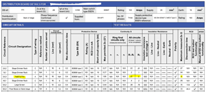

    Sorry about the pics in my first post - not sure why they lost resolution on uploading.  Here they are again, hopefully clearer;
  • So the the murk vanishes with the new pictures.
    Look like someone has gone all over "initial verification" style on an EICR.........................................................................good luck ?

  • DB MP1 is single phase and feeds DB FF1.
    FF1 is three phase.
    I'm guessing the entry for MP1 isn't correct!
  • Are you able to look at the offending breaker yourself and determine it's rating, and eyeball the size of cable coming off it?
    160A and 100A should be easy to tell the difference, as should 35mm vs 25mm, unless the cable really does change size halfway along.

  • Somebody has got in a right old muddle - that's being polite; or is just sloppy.
    If MP1 is the main board, it seems odd that the supply is only 25 mm² with a 16 mm² earthing conductor.
    Then we have a distribution circuit to GF2 with 35/25 mm² conductors and a Zs of 0.16 Ω; yet by the time that they get to GF2 they have shrunk to 25/16 mm² and the Zs has fallen to 0.06 Ω. Similarly, the supply to FF1 is 50/35 mm² with a Zs of 0.19 Ω and once again they have changed by the time that we get there to 25/16 mm² and 0.08 Ω. All the max permitted Zs for the 60898 MCBs are for the next size up in Table 41.3.
    I could go on, but I am bored now. ?

  • And a 315Amp main fuse supply to a main switch in 95mm apparently- did the inspector bring this up somewhere in the codes? It may be OK depending on installation method, but I'd double check the installation method----- perhaps the inspector mistook 120mm for 95mm?
    I'd certainly get the inspectors governing body involved. If he's NICEIC he'll have an NICEIC area engineer (That ostensibly checks his work quality once a year) that may be willing to swing by?
    There's certainly enough there to justify dis-believing his recommendations and recommended work as a result.
