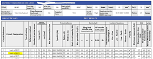

I am reviewing an EICR recently issued for a building with several Distribution Boards feeding sub-Distribution Boards.
I have noted that in some instances, the figure recorded for 'Zs at this board' is significantly less than the Maximum Measured Zs for the circuit recorded on the feeding DB.
e.g. DB FF4 is recorded as being fed from DB FF1.  The feeding circuit to DB FF4 is recorded as having a Maximum measured Zs of 0.4 Ohm, but the 'Zs at this board' for FF4 is recorded as 0.05 Ohm - which is less than the 'Zs at this board' recorded for FF1 (0.08 Ohm) - and which, is in fact, in turn itself less than the 'Maximum measured Zs' for the circuit feeding it.  Can this be true or are there errors in the report?  I thought that cascaded Zs can only get larger due to the added impedance of the feeding circuits? This is not my primary area of expertise, but I am concerned that the EICR is being used to justify the upgrade of several circuits which have passed previous inspections with no problem (hope the resolution of the extracts from the EICR below are sufficient resolution to read)...
Many thanks if anyone is able to confirm my concerns or otherwise put me straight...
  • Were the measurements taken with all loads disconnected? Loads switching in and out can affect results.
    I could also foresee theoretical situations in sprawling buildings, where what's locally bonded provides a low impedance earth path back to the MET, but perhaps not to that extent?
    Of course, without knowing anything about this particular installation, I would certainly be asking the question you are asking.
  • Would expect mainswitch of tested DB to be off? Likely two differing inspectors per DB. Blurred image gives no clear detail, BUT, looks like R2 and Zs recorded on distn circuit to DB. Odd for EICR. Perhaps this Zs calculated, erroneously, simply from a wander lead origin to DB [R2], then inspector of sub db did live Zs test.
    edit to add:  Mixed disconnection times one DB to the other.
  • but I am concerned that the EICR is being used to justify the upgrade of several circuits
    But is there any observation for that dist'n circuit recorded suggesting "upgrade" ?
    That will indicate if it was just a clerical error or not.
  • In a steel framed building you might get this, as in effect the later disboard, connected to the metal building frame, is better grounded than the board that supplies it if that one is say on a brick wall. However, that is not a common situation.
    But, are any of the distribution circuits Zs so bad that a 5s disconnection would fail, and are any of the final circuits so bad as to fail 0.4 seconds - if not then it is nothing more than a comment. What 'upgrades' are being proposed, and why? -  it may be sensible - it may be just making work.

    In the FF1 for example, the 'Zs at this board' is recorded as 0.08 Ohm.
    Circuit 1/L1 records 'Continuity R2' as being 0.1 Ohm.
    'Maximum measured Zs' for this circuit is recorded as 0.04 Ohm - less than the R2 for the circuit itself. Can this happen?
    Circuit 3/L3 has a 'Continuity R2' recorded of 0(?), or 'R1 + R2' of 0.01, and yet a 'Maximum measured Zs' of 0.4 Ohm. I would have expected the measured Zs to be very close to 'Zs this board' + R2. (neglecting the fact that he has managed to find an impedance-less conductor linking two Distribution Boards.

    Originally posted by “Peter S3:
    (hope the resolution of the extracts from the EICR below are sufficient resolution “
    Hi Peter welcome to the forum :) Not your fault but those pics are making my eyes hurt, how did you upload them? Pictures that appear blurry could be previously clicked on and viewed in more detail, I am not sure if this has changed recently.
  • Peter S3:
    I am thinking his EICR is just too scrambled and full of inconsistencies to be taken as credible.
    Or am I missing something?
    I cannot read your original charts, but there seem to be some basic errors in the later ones. Sections I and J: nominal voltage and frequency appear to be measured. If Ze = 0.14 Ω then at 243 V the PEFC is around 1.717 kA, but matey seems to have forgotten the possibility of a L-L fault. Why has supply polarity not been checked? The size of the MPBC is not given and there is no indication as to what is bonded.
