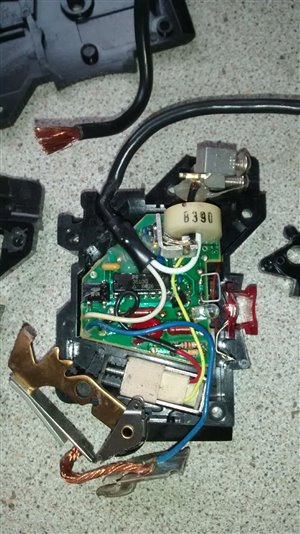

  • Hi all.
    I received and opened the Federal Electric RCBO I got for a tenner from ebay and have found the same thing. No instantaneous trip
    mechanism.
    Hard to believe on an RCBO.
    This one is actually a 10mA.
    It's the MCB not marked with types that are like this but all the RCBOs I saw on ebay had no type marking.
    It's not that easy to tell from the picture as I had to remove it but there is a centre part so the thermal mechanism would be
    positioned above the electronics, but separated. You can see the fixed part of the contact near the coil.
    The electronics are permanantly fed so it warms up even when switched off and if the RCBO is plugged in first the neutral tail
    becomes live. The trip coil is directly fed by the yellow wire on one side from the L on the load side, so at least if it trips it
    will cut the power to the trip coil. The test button is a link to neutral but there is no switching on that so keeping it pressed in
    after tripping will overhead the test resister. However, I tried this and nothing overloaded; don't know why. Maybe I didn't hold
    it long enough but in theory the length of time I did hold it I expected some noise and wisps of smoke.
    On this one the test button is transparent red and there is an trip LED on the board. Some have non-transparent yellow buttons so
    they probably don't have this LED.
    This is a 30A breaker and the L and N conductors seem a bit small.
    The large neutral tail is misleading as it is connected through a soldered crimp to 2 white conductors for load current and neutral
    link to the circuit board.
    It seems a bit strange that what seems and old bakerlite device with no instantaneous trip mechanism has more modern LED and 2 IC packages on the circuit board.
    b00d42da2407b4089ca5336b52c249aa-original-federal-electric-rcbo-without-instantanious-trip.jpg

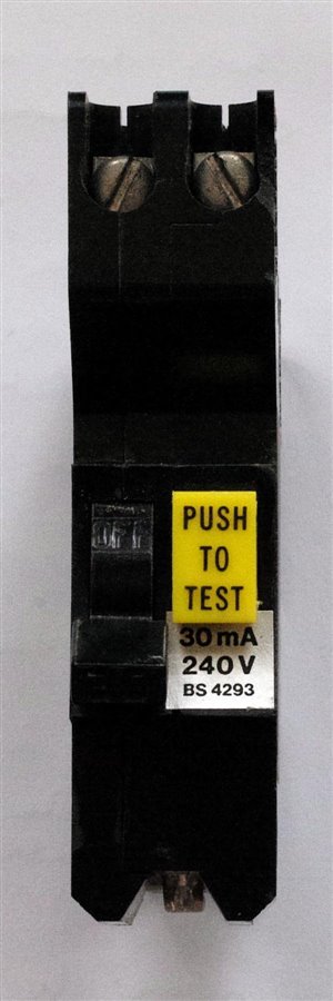

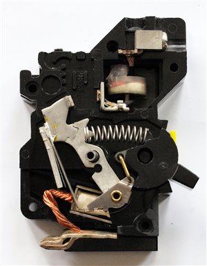

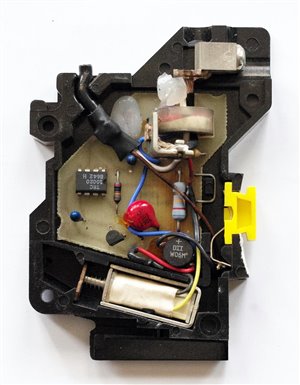

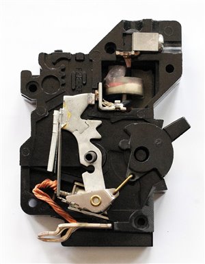

  • Here's one which was almost certainly installed in 1982. Definitely made in England. It was in a 4-way metal CU which served a garage and outbuildings. Only two ways were used - this was one of the spares. At least the test button worked!
  • Thanks for posting the pics of that. It shows the make up in better detail. I pulled my one apart too quickly.
    I notice that the feed for the board is on the load side on this one instead of the supply side on the one I opened.
  • Thanks for the further pictures. I have never come across such things in the UK - interesting!
    Now, thinking on the comment "without the inclusion of an instantaneous trip mechanism", I start to be curious about whether they do some clever trick like having a deliberately bad balance on the RCD core so that high overcurrents - even though non-residual - cause the RCD part to trip, or some other sensing. I admittedly can't see any other way of sensing in the picture, and can't imagine how a core and wires looking like this could have a reliable level of imbalance. (Sometimes the designers of these things have cunning tricks: for example, a chip commonly used for plug-in RCDs (RV4145) includes a rather neat detection of downstream N-E faults described on p.5, end of first section, which is wanted because these faults in a TN system can make the RCD much less sensitive to L-E faults by creating in effect a short-circuited turn through the core.)
