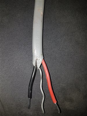

My daughter is having her Edinburgh 1st floor flat prepared for renting and it needs some work highlighted by an electrical safety report. Some things have been noted as requiring remedial work that seem odd to me:
  • Two sockets are noted as being wired in Aluminium Twin & Earth cable. Is this likely? It looks to me like stranded copper.  Would it need replacing even if it is as this would be a pig of a job as the wiring is under a laminate floor.

I have a photo but I can't work out how to upload it. It says drag but that doesn't seem to work.
