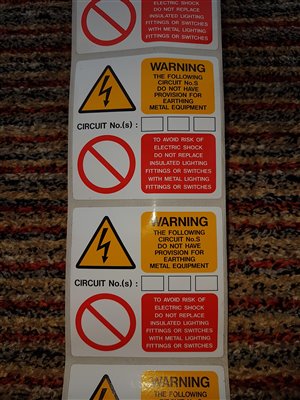

    Also, how does an EICR turn into a Safety Certificate in the context of rental (in Scotland). Are things like no earths at plastic ceiling rose with pendant (plastic) lamp holders a reason to say a property is not fit for rental?
    Now you have opened a can of worms, the straight answer is probably not fit for rental. It comes down to supervision of the installation to ensure plastic fittings are not replaced with metal fittings that require an earth connection for safety. The regs can be interpreted as it's okay in an owner occupier home, but not in a tenanted home.
    I have just sat through the Aico core training webinar and there is a similar issue with having replaceable batteries in heat and smoke alarms, okay for owner occupiers, but not in tenanted homes.
    Depends whether you give it a C2 or a C3!
  • Thanks Andy, but changing the light fittings should be forbidden by the tenancy agreement anyway!
    Chris - exactly. Is there any definitive ruling on this sort of decision?
