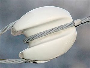

  • In effect the catenary wire is interconnecting two TT earthed green houses, to make one larger TT zone. This is only an issue if there is an RCD failure and then instead of one live greenhouse you have two. I suspect the risk is low, and acceptable - no worse than say a metal fence or similar beside the greenhouses.
    You could over sleeve the catenary wire or the hook, or  even use an egg insulator in the caternary wire, 3504e2e5eedce7785d8c386d8cca3e5e-original-330px-tamagaishi.jpg
    example
    but I cannot see that the risk is high enough to warrant it.
