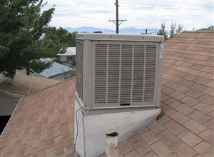

  • Evaporative coolers work EXTREMELY well in 2 situations:
    1, if you want something to blow a stream of cooler air at you to help you sleep. The effect is then concentrated on you, and not at 'reducing the sensible temperature in the room as a whole' And they work a LITTLE better than the average fan, the air does feel sensibly cooler than just with the fan (I have a small unit that can do both... when the water pump is OFF, the air does feel slightly warmer on the skin) but the effect's not huge.
    2, in desert areas when applied to an entire building.
    Thinking southern california style 'swamp coolers'. They basically have a mesh of straw contained in a grid surrounding a fan... and a pan of water circulated by a small aquarium style pump to keep the straw grids wet.
    The fan blows an ENORMOUS amount of air into the house, therefore the inlet vent is usually in the entrance hall...
    This expels the cold air to the outer environment before condensation can happen.
    Oddly the tiny thing in the pic entering front left is not a cable of any kind, it's the water supply. They use about 1/8" microbore tubing  to keep the reservoir topped up. A common failing is that the ballvalve fails and ... yeah, the fan doesn't only blow cold AIR into the hall <grin>
