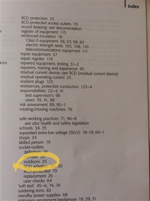

    It is indeed open book and multi choice. So what is the rcd amp values for oitdoor sockets? 32a? And is the minimum ip rating ip64 or 68?
    Thanks for the answers guys.
  • Hi
    like mapj1, I'm not sure what is in your syllabus. But a quick scan through IET code of practice (4th Edition) states in 4.2 that any rcd used to provide protection for equipment used outdoors "is required to have a residual operating current not exceeding 30 mA at 40 ms."
    Would this have been enough to answer the question, or was more detail required?
    (out of interest, what is the format of the exam? Is it multiple choice and open book?)

    I get how the rcds work and thier purpose. The thing is the iet book for code of practice for in service inspection and testing of electrical equipment and the tutor made no reference to outdoor sockets and appliances.
    Question I have is, are the trip times, trip ma value, rcd amp size the same as your standard 32amp indoor ring mainspring? And what is the minimum I.p rating for outdoor sockets?
