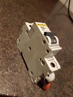

  • One that was on the dashboard in my van having been replaced a couple of weeks ago.
    I had another pre-used MCB, the clip on it was extremely tight and rather than trying to open it up I swapped it for the clip off this one as it was a much better fit.
    Whilst I have obviously seen issues with these devices, it has not been the clips that have failed although they vary in fit regards tightness.
