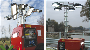

    If you need to supply only LED lights for this application, well there are already dedicated Lighting Towers on the market already with different ratings up to 2000W.These are already well designed and rated as per specific application.
    This will be suitable only if you do consider to provide current for LED lights only .Then for connection via PLC , then you must check if there is the option of bus connection on the main board for this type which I doubt.
    If you need light and plus other current on other phases,then instead of a single phase gensets maybe you need to consider a 3 phase gensets and maybe >=50KVA but please reconsider the load calculation. Typically on a 50 KVA 3 phase,there is already the bus connection for plc connection and connectivity,However recommended to check on the specs.
