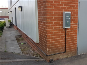

    I posted a picture of a TT EV charging point on a steel building the other week I was stood looking at , I will find it again.
    Andy B
  • I looked at this and thought although it's convenient the EV charge point would actually be better on a freestanding pillar at the other end of the car park with its rod under it.
  • If you are being really picky it probably is possible to park a car inside that unit and pass the charging lead back in through the personal door to charge it, it’s definitely possible to park within reach of metalwork connected to the PME earth system.
    There is no particular risk from using that charging point under normal circumstances, but the separate earthing zones are not clearly defined and separated. It is actually quite a challenging installation, had the installer suggested digging a trench and running a cable up the car park to a free standing pillar then reinstating, everyone would probably think he was going completely over the top.
