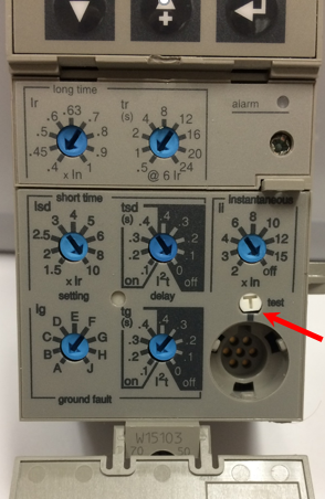

  • it depends how you twiddle it - unlike a normal MCB with a thermal and a magnetic part, in the modern devices there is a current transformer and some very flexible programmable electronics, so you can make the instant threshold move, or have a variable multiplier. However, as you only use the adjustable because you really do want a funny rating, then it behoves the person making the adjustment to understand the conditions well enough to make an informed choice
    (and maybe to note the settings in a label on the panel and then seal it against tampering.)
    Note that really this is all about faults to earth and shock protection, the fast trip multiplier part is irrelevant for overloads and slow overload is normally what matters for fires, where a 5 second response time is just fine. (hence the preference for either a seperate earth fault relay, or a breaker that includes a programmable RCD function, as then you can separate the cases quite easily.)

  • All of the MCCBs I have seen at that rating range have a fixed value of Im.  If the Ir setting adjusts Im then such information is bound to be present on the front panel of the device.
  • Lyle,
    Completely agree here. The Im setting is unlikely to be adjustable as it doesn't rely on a trip signal from the electronics, but is rather a magnetically induced trip induced by the current flowing (hence Im - m for magnetic). Most importantly the short circuit rating of the circuit breaker is definitely not changed when the current settings are adjusted.
    However some circuit breakers have a short time setting (probably 250-400 ms) which is not the same as the instantaneous trip, but is a fixed (short) time trip instigated by the electronics. This trip, being set by the electronics, is adjustable. However I have not seen such a trip setting on MCCBs before but rather on ACBs.
    Alasdair
  • Some makes of programmable breaker (like the micrologic below) are very complex and manage to still be very clear with their labelling
    Other models may not be, and a careful read of the data sheets example of less clear one is always good.
    You may well be right that in the lower current ranges, only the smaller simpler ones exist, I had not spotted that in the OP.
