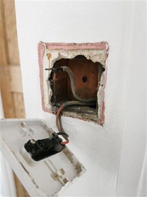

    I decided to use low-profile plastic surface pattress boxes rather than metal back boxes. Here's some examples of the old and the new.
    Old two-way switch with wooden back box.
    New surface pattress box fixed to firm plaster (not the same switch as above)
    New light switch with nylon screws
    All other light switches with metal back boxes have had the metal screws replaced with nylon. All light fittings checked to make sure the tenant hadn't changed them. New big label on consumer unit.
    I'm not sure there's anything else I can do without rewiring the whole lot, which I will do at next change of tenancy.

  • In your scenario if the back box is all insulated there is no need for nylon screws.
    Yeah I wondered about that. Some of the switches have DO metal back boxes with nylon screws, so I did it throughout.
