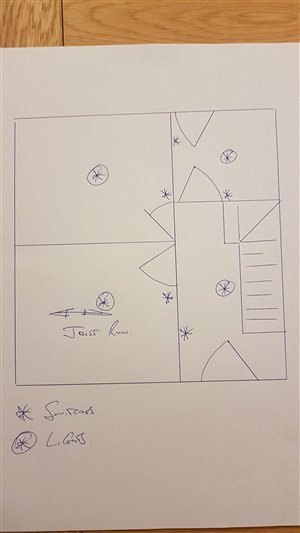

The lighting circuit has no CPC (earth), this is not uncommon in older houses. For that reason all light fittings are Class 2 i.e. plastic with no metal, and there is a clause in the tenancy agreement which forbids tampering with the light fittings (this is a house we own and rent out).
Previous EICRs did not even mention the lighting circuit because of the Class 2 fittings. I have just got a new EICR with an observation "lighting circuits have little or no earth" and classification code C1 ("Danger present, risk of injury, immediate remedial action required"). The overall assessment says "Unsatisfactory" with the comment "Needs updating to current regs". This can only be fixed by a complete rewire of the whole lighting circuit.
This is pointless, there are no earth connections in the plastic fittings.
Any thoughts? Many thanks.

    Most houses have the light switches either side of the central hall wall on the ground floor, generally you can get a run of boards up along the landing and into bedrooms then work from there the using rods from the centre light positions.
    And surprising you can often pull cables down the wall behind the capping.

  • Look at a typical semi that hasn’t had the lighting circuit altered in fifty years or more, there aren’t light switches on the perimeter, they are generally all down the middle and accessible from above by lifting boards on the landing and third bedroom, though the kitchen being under the bathroom can be a bit of a sod.
  • But just hope that some tight wad electrician did use all the odd bits of capping up leaving a sharp end on the join part way up the wall. Indeed you may need to bend the ends of the capping back if it wasn’t done in the first place.
