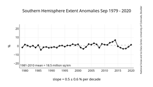

    Why is there a need to 'hype' normal weather? Is it beacause there is no real evidence for AGW. There is plenty of evidence that the Earth is naturally warming since the last Ice Age. Arctic ice cover is also slowly decreasing for the same reason. It is interesting that Antarctic ice is stable to increasing.
    https://nsidc.org/data/seaice_index/

  • I have been looking at your graph carefully, as well as the error band figure. Presumably, the line shown is a least-squares regression, this should show the statistical significance as well, which is low. In other words, one cannot make any predictions about any future temperature. NASA talks about the actual ice cover each year and it varies hugely, again it is not possible to predict what will happen. Generally, this is called weather.
