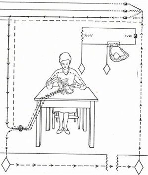

    Ancient toasters remind me of this one of several graphic examples of dangerous situations, from the 1929 book "Rural Electrification" (A. Ekstroem and V. Ekstroem).  Weren't illustrations better in those days?  This one is supposed to indicate the danger of earthing a chassis, when in an otherwise fairly insulating environment.  It seems toasters then were like small electric fires, toasting one side at a time.  I hope yours recovers itself with the new parts.  My 65 year-old Belling fire still runs well.
