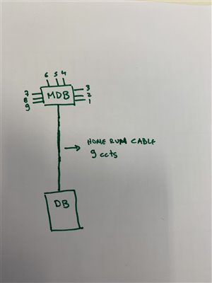

Hello, I am trying to confirm the appropriate cable size for a home run cable in a modular wiring system. There is a 9-port MDB that supplies  radial circuits with socket outlets. As per BS7671, the appropriate grouping factor to be applied is either 0.5 (table 4C1) or 0.45 (table 4B5) assuming all circuits are carrying more than 30% of the current capacity of the home run cable. This ends up in having to use 6mm2 or even 10mm2 cables instead of 4mm2 that would be expected for radial circuits in 20A MCBs.

    The issue is that I not sure how to justify a group factor close to 1. The 4mm2 ccc is 32 A for ref method B (assuming the home run as conduit) and each circuit should normally be drawing around 5-6A. But as these are general sockets, should I not take under consideration that 20A could be drawn? This would mean that the ccc of the cable would be 20/0.5=40A and I would have to go with 6mm2 (41A @ ref Method B). Each circuit is supplying 5-6 double sockets.

    As far as I can see with the arrangement you are proposing you probably need the equivalent of nine big cables running through the box and conduit, all the way to the socket fittings I’m not seeing the advantage of having the box.
    Sketch it out on a piece of paper and take a photo to post, perhaps it will make more sense.
     Andy B.
  • The question is about the home run cables from the DB to the master distribution box. After the MDB I dont think there is an issue with 4mm2.
    I am trying to show that 4mm2 should be fine for the home run cable. just not sure about the details of the proper calculation that should be considered

    If there are not nine circuit protective devices in the MDB to protect the nine final circuits you are looking at wiring everything in 4.0 mm and having a 32 amp protective device upfront of everything in the distribution board.
     Unless the MDB has nine circuits in and nine out with nine MCBs in the upfront distribution board.

  • The question is the same, what is the supply overall rating going to be? If 60A you have only 2 circuits spread over 9 cables, use the value 1. Even if 100A the value of 1 is very safe, that is only 11A average per circuit with 4mm cables.
