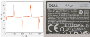

    Some examples of IT-related loads are on this page it_power, which shows the waveform, harmonics and power for different operation states. See how big the third harmonics are compared to the fundamentals ('1st harmonic'), particularly in the monitor. But the bigger server-like computers have much lower third harmonics. Compare the waveforms with the laptop-charger waveforms below, to help estimate the harmonics for the chargers.
    Mike has already given a good summary of rules that modern devices should follow. It's the large numbers of small, cheap electronic items that contribute the highest harmonic content. When one gets into bigger electronic loads such as heat-pumps, the waveforms are much closer to sinusoidal. Plenty of modern devices that students would be likely to have can have very peaky waveforms like the monitor in the above link, as they'd typically be only some tens of watts. A good general rule for cheap, small electronic goods is that unless you force them to be manufactured to have more than a diode bridge and capacitor at the input, they won't be.
    I did some measurements on lots of types of modern power electronic loads back in the spring, mainly interested in their reactive power production and in how broad a band of input voltage they draw near-constant power over (answer: a remarkable range, even for heat-pumps and induction hobs). Below are examples of waveforms from a couple of laptop chargers. See how the 65W one is peaky anyway, and the 90W is peaky too when on low load when the laptop is just sitting idle and fully charged, but it's better behaved when running nearer its rating. USB chargers tend also to be very peaky. So these sorts of loads can easily have third harmonics over 50% of the fundamental (or even above 50% of the total rms current) - compare to the waveform+harmonic plots in the above link.
