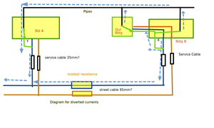

  • That rather depends on the current paths. If the CPC finds itself and the shared plumbing form a lower resistance path than the street main and service cable it could carry more than half of the neutral current for the building, and neutral current for any other buildings on the same branch. It is safest, but in most cases overkill  to rate the CPC based on the current rating of the incoming neutral. In the drawing below, building A may end up passing current dependant on the load in building B.
