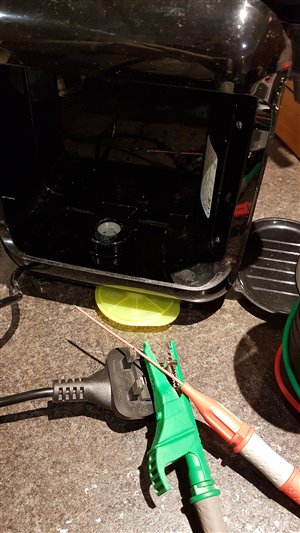

    Coffee machineOK 3rd problem class one appliance with no exposed metal work to connect test lead too how can I carry out the earth bond test given it is a class 1 appliance and not a class 2 appliance like this Coffee machine
    I have one in my kitchen, next to the "cordless kettle" I'll have a poke later.
    More interestingly I have identical downlights in my ceiling, some are Class I with an earth and some are class II, when I enquired why the manufacturer told me that they make them up to customers specifications, so the Class depends on what the customer asked for; they could all be Class II, but some customers prefer to see them earthed, so they add an earth fly lead and terminal if requested and I had ended up with a mixed batch.

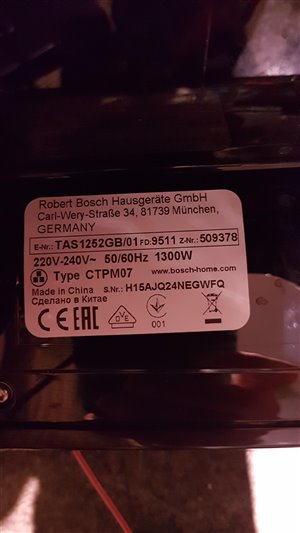

  • Class I with a three core 0.75 mm flex, but definitely an all insulated plastic enclosure without any gaps.

    Sparkingchip:
    Thanks so for all purposes fails the earth bond test as un testable
  • Alex13:
    Sparkingchip:
    Nope ... I disagree. "I can't" doesn't mean "It's no good".
    As I said earlier, to fail an appliance that has its exposed-conductive-parts shrouded to prevent a burn hazard is absolute nonsense. There are good reasons why many heating elements MUST be Class I, and that's to do with preventing overload and fire as much as electric shock ... and not impeding heat transfer at the same time.
    So, what's the answer ... well, again I said this earlier - this type of appliance has a plastic shroud over its exposed-conductive-parts, and someone who is competent to service and check that appliance will remove the cover and perform the test the way the manufacturer intended.
    The filter coffee machine I have at home has a similar issue - the only way to get to the element to perform the earth continuity test is to remove the bottom cover, which has tamper-proof screws. The heat plate is teflon and I can't get an earth probe to get a circuit from outside the appliance.
    Get it tested by someone who knows about that type of appliance.
