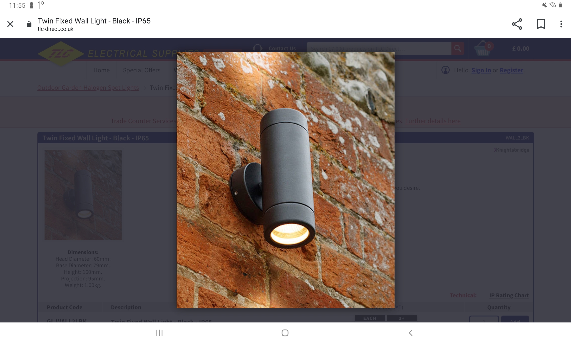

    Hi. Thanks for your reply. These are basically the lights I want installed. I have put25mm trunking in the ground and want to attach  3 of these to wall in the gravel drive. I don't want to go into the lightfrom the back as that would mean chasing the brick wall. So I want to stand it off the wall to be able together cables in the back and loop into the next light. I don't really want to mount a piece of timber off the wall to be able to run the cable behind and into the back of light.
    Thank you

    I did think of the corner bracket and just bending the ends to a 90 degree but at 17 quid a pop it is expensive. Then the flood light bracket but not sure that would work as bolts would be needed and probably ruin the integrity of the ip rating. Screenshot_20210107-120448_Chrome.jpg

  • BESA boxes are for conduit, rather than trunking, and thus are compatible with 20mm (or 25mm) threaded fittings e.g. cable glands. The "U" shape ones (with two entries, both pointing downwards) usually have the screw lugs horizontal too. If you're googling then then they're perhaps more often listed under "conduit boxes".

  • Yes, you can put glands on 25mm flexible conduit ... although they'd normally have 25mm threads, rather than 20mm.
    Generally cables buried in the ground need an earthed metallic armour or earthed metallic sheath - to ensure safety if they're struck by digging tools. Unarmoured cables like HiTuf  aren't suitable for burial unless in a duct/conduit that offers an equivalent level of protection ... which I suspect a bit of plastic conduit isn't going to. The more usual approach is steel wire armoured cables, ducted underground if you prefer, glanded direct into the conduit boxes (using "outdoor" (CW) glands, not the cheaper indoor (BW) ones).  You'll also need a bit of care to ensure that the conduit box is weatherproof when installed - especially around the fixing holes and junction between the box and fitting.
  • here are the   fitting instructions for that up-down wall light
    Looks like rear entry it is.
    you can use those boxes with soft cables as well, with compression glands   but you do need to be careful to get the right thread and the right  cable size though, there are a lot of options.
    mike.
