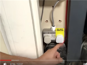

Fire Alarm Main Supply Source.
Pls. see 2.12
https://www.youtube.com/watch?v=GxYnw_OKyEs
Z.
  • Plugging in a fire alarm is a bit unusual,  presumably not a problem to BS7671 as  it is an appliance wired like this and out of scope, but I assume it is hardly to BS 5839 or  whatever it is now for fire alarms in blocks of flats. Also a plug will not be not the right sort of terminals and cord grip for the cable.
  • Does not comply with BS 5839.
