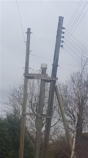

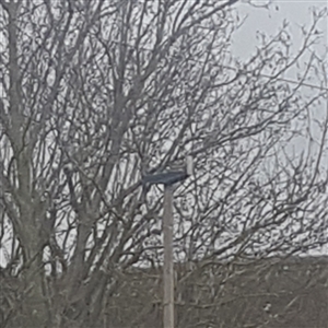

  • That's just part of a run of overhead cables I was looking at a few days ago.
    The second picture is of one of the props under the spans that has been installed because of the sag due to the poles leaning over.
    Sometimes it might just be easier to replace things.
