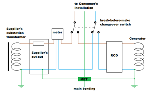

    This drawing by another forum contributor from a post a while back shows an example method for how it can be done with no issues.
    Obviously the neutrals (and lives) from anything not on the genset changeover will be left connected to the main supply, but that is not an issue - you would never see shared neutrals between circuits anyway, would you ?
    Edited to link to AJJs image - which I thought I had, having found it by google, and recalling the original discussion was about a chap with a Lister genset. I was a but surprised it was on photobucket, but hey ho it must have been 'lifted'. Apologies Andy.

    To (hopefully) clarify - the requirement to have only a single N-PE link only applies to each independent system - where you have two distinct systems (i.e. where there are no connections between the live (either line or neutral) conductors of the two systems then you can (and indeed must have) an N-PE link in each system. The earthing/bonding arrangements can be shared of course.
    In all the above cases the change-over switch should ensure that the generator supplied circuits are kept separated from the grid-supplied circuits - so you have two distinct systems, even if they're both running at the same time.
  • Oh, and hopefully a slightly clearer (less photobucket watermarked Frowning2) version of that diagram:
    (as hinted above, unless the generator is quite substantial it may well not be able to provide enough current under fault conditions to operate overcurrent protective devices for ADS  (Zs readings can't always be trusted on that score either) - so RCD(s)s may be required.

  • AJJewsbury:
    Apologies, I recalled the diagram, but not the creator from a discussion about a Lister unit, and so I googled for IET forum Lister genest changeover, and got the photobucket one. It must have been lifted by a 3rd party if that was not you.
    If the forum search was better I might have been able to find the original...
    Mike.
  • No apologies needed Mike. I'm happy if it's proving useful. I presumed the watermark was one of photobucket's attempts to persuade people to use their premium service after they blocked images from free accounts being used on public sites.
