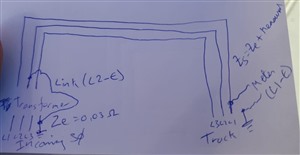

    Sorry to drag this up again but I was hoping you guys may be able to give me some more assistance!
    So I have now done a lot more research into these systems and read some more standards, I believe that as per the standard I have to test the earth loop of my final circuit according to my sketch (apologies for how terrible and hand drawn it is......) but when I do I get no connection. Would I have to do this live and if so how do I do this safely? Is there specific equipment for measuring the earth loop on IT systems?
    Thanks in advance!
    Tom
  • tommatwalker:
    Thanks in advance!
    Tom
    You may like to look at Fig 9C, Appendix 9, of B.S. 7671 page 491. It illustrates the IT system.
