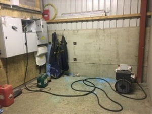

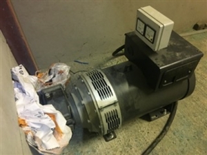

Hi
I have a tractor driven Backup generator to install on a farm shortly and have a query regarding the earth spike. Does it need to go directly back to the MET or can I connect it directly into the generator earth terminal, the latter being Quite a lot simpler   In my case?
thanks

    There is another point and that is the position of the generator N-E bond. The generator will be insulated from the Earth if on the linkage (normal), and failure of the Earth cable core quite possible, and will not be noticed. The safest place for the bond is therefore somewhere fixed in the switchgear to ensure ADS will still operate correctly. Again this is not a problem if the generator is fixed down to a base and a long  PTO shaft connected to the tractor.

    My changeover panel will have have rcd protection built into it but the generator does not have rcd protection in it. As such, there will be about 10 metres of cable from generator to changeover switch without rcd protection

    I was always taught that if you have an alternative source of supply eg. Backup generator then you must always have a reference earth connection that is within your control. The theory behind this being that if you are running your backup generator due to a supply failure, the dno may well have removed their earth connection as part of their supply failure works and if I am relying on it, it may not be available. This has been well debated on this forum

    I agree with Mike, this is not correct if it's a TN-S earthing terminal provided by the DNO. See Regulation 551.4.3.2.1:
    551.4.3.2 Additional requirements for installations where the generating set provides a switched alternative to system for distribution of electricity to the public (standby systems)
    551.4.3.2.1 Protection by automatic disconnection of supply shall not rely upon the connection to the earthed point of the system for distribution of electricity to the public when the generator is operating as a switched alternative to a TN system. A suitable means of earthing shall be provided.
    The reason for this, is that the supply cable may break.
    But good question whether it's "real TN-S".
    The added difficulty with a DNO-provided earthing terminal is the need to provide a switched N-E bond as well as ensure adequate isolation from the live conductors of the grid as part of the supply changeover arrangements - which, if the generator has its own electrode completely, a simply "All lines and neutral" changeover switch is probably best to achieve all of this.
    Regulation 21 of ESQCR would apply.

  • Relying on the DNO earth (TNS or other) may not be wise if the power is off completely, as it may be off because the supply cable is damaged or because the DNO are working on the earth. Supplementary generation like solar panels that cannot run as an "island" does not have this issue.
    In reality you will have plenty of local  electrodes in the form of plumbing, and barn foundations and  and so on in the ground, maybe the odd container on skids but you may well have nothing that is labelled as an official one.
    I assume the wire from genset to buildings will include a CPC ?
    Regardless if the genset sports an electrode and an RCD that should be fine, whatever the DNO supply does.

    Most of the PTO driven standby generators I worked on were Froment (spelling) with the orange lamp to set speed. These were 15 kVA and on dairy farms. Others just had a PTO driven vacuum pump for standby. Not really applicable these days with everything dairy wise geared round electronics. I'd be surprised to now see anything much bigger on a PTO as typically a dedicated generator is used to supply full load demand.

  • No Hugh that isn't right. If the supply is TNS you don't need a spike, as you have an Earth connection which should give the same protection as the mains supply. I assume the farm has a transformer close by for its supply, which will have an Earth mat or whatever. Everything should have RCD protection already, (section 705) 705.411.1. All you need is a change over switch in the tails (only phases and neutral) between your generator and the mains supply, and a 300mA RCD in the generator supply to provide Earth fault protection to the connecting cables etc. and the existing Earth will work normally as long as you connect it! I expect a tractor unit will be at least 40kVA, so all your normal OPDs up to 40A or so should operate normally. If the supply is bigger (for a grain dryer or similar) then it is likely the Generator may not power the entire load, some warning is needed because you will stall the tractor or cause mechanical damage somewhere. Ask any further questions if you need.
