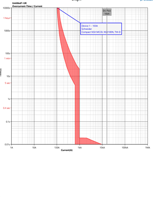

I having trouble finding trip curves for the single pole MCCBs, the ref code is MGP1001L1 for the first phase.
I can find the selectivity tables for Compact NSX series which can be single pole with TMD trip unit.
Can anyone shed some light?
Thanks
  • I think this is a Merlin Gerin part (the MG part no...)  and the L1 is the protection level, which partly relates to the curve type. You could do worse than ask the Schneider UK helpline 0870 608 8608 in the morning.

  • I will get print off a curve for you from my Amtech when I get a spare 5 mins.
    That I think is a 100A single pole MCCB. The L1 indictes it fits in a L1 position in the MCCB panel as for L2 and L3 varieties.

  • The MGP is just an NSX with the busbar cassette attached - the curves etc are the same.
  • Here we are.
