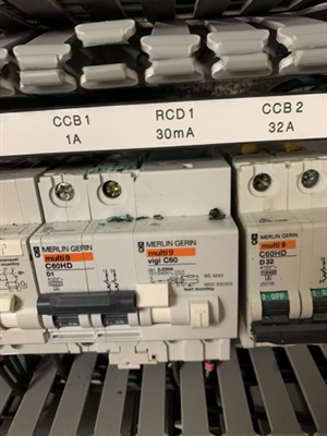

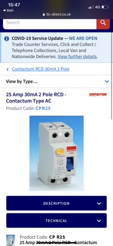

Is there anything preventing us from using these type of RCDs for a 55-0-55 circuit?
the picture shows the original set up. And the replacement b27da3454a5814fd623eb7a7fef4edcb-huge-87007dcb-a17d-44db-b7f4-06ceebdf5a1f.jpg
  • Some RCDs derive a power supply for internal electronics from the LN voltage. Not all of these are suited to a pole to pole voltage of 110 and may not operate, though I suspect most will.
    Given the very short on-line data for the CPR25, the easiest is an Email or  phone call to Contactum UK in the morning - they should know. If they do not, do not use them.
    Technical enquiries
    Tel: 0208 208 7423
    Fax: 0208 438 0281
    technical@contactum.co.uk
    Mike.
  • I have used a standard 2 pole RCD on a center tapped 110 volt supply as a short term expedient to improve my own safety.
    I do not believe that such use is compliant with the regulations because the built in test circuit wont work and there is therefore no way for the non technical user to verify operation.
    The test circuit invariably consists of a push button that connects a resistor between one pole of the input and the other pole of the output. The value of the resistor is calculated to pass the nominal trip current at the lowest "normal" mains voltage. Probably to pass 30ma at 217 volts for the common type.
    At 110 volts the test resistance will only pass about 15ma and tripping on pushing the test button is unlikely.

  • the picture shows the original set up. And the replacement
    The original seems to be a D1 MCB with a vigi unit attached - in effect an RCBO - just checking that you're only suggesting replacing the RCD element with the RCCB rather than the entire unit.
  • AJJewsbury:
    I had similar thoughts.
    First off check the original RCBO is suitable, it may not be performing correctly because it is unsuitable for the installation.
    Then if it is suitable, consider replacing like with like.
  • So it is in theory acting as an RCBO. I’m confused why the original designer would have specified that unit. So functionally it would work under fault?

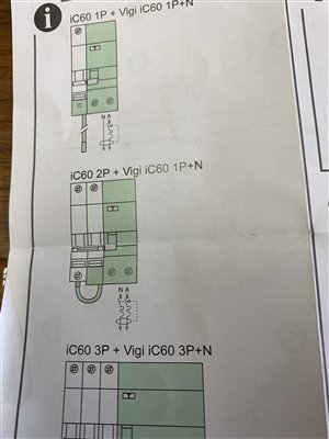

  • these are the replacement I have for the 55-0-55 are we saying the test button still won’t work?
    CC55936A-58FC-4E87-97D0-76D07D53E2A9.jpegf81d3fba97b9fc73e23ec6b24bc1335a-original-a331d126-18bb-4e30-a87c-200bf649ba27.jpg
  • I suspect that the test button will not work, unless the makers will confirm otherwise IN WRITING.
