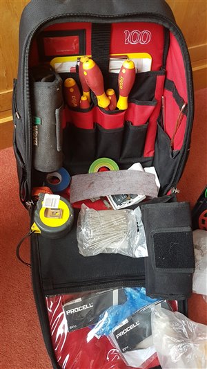

    At the beginning of last year I bought a new rucksack on wheels tool bag and tools just for doing EICRs.
    So as an example, I went to do a landlords EICR in a flat over shops in Stourport on Severn town centre, I parked in a car park and paid to park using an app on my mobile phone. I extended the handle on my tool bag so I could pull it on its wheels to the flat which was a considerable distance away, I clipped my rechargeable work light to the tool bag handle and stuffed my coffee mug in a side pocket. Then I pulled the bag through the town centre with my tester hung over a shoulder and carrying an aluminium hop-up in my spare hand.
    In the bag I had a bag of long accessory screws to refit fittings after inspection and to replace the odd missing screw, labels as commenting on a missing label is petty, spare batteries for smoke alarms, an abrasive sheet for occasionally cleaning up terminals, a few cheap terminal enclosure boxes just in case there’s one odd unenclosed terminal strip and that’s it.
    There’s no way when that when you’re working in a flat over the shops doing an EICR that you are going to keep nipping back to the van to get materials to do repairs as a gesture of goodwill will, when you have to get out before the parking period expires in the short stay car park and you have got to get to the next job. But why should you?
    In the van itself I have a small stock of spare smoke alarms of various types and fittings, etc. But if I have to go and fetch materials to make a repair it fully chargeable including the walking times.

  • I just looked at those photos and spotted a handy item that wasn't on my list,  it's always good to have one of these to hand for that 16 mm twin and earth cable terminated into the fused main switch with its sheath stripped back.
