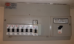

  • There are very good reason why I don't do electrical work without inspecting the consumer unit and intake equipment first.
  • I found both of those in privately rented homes during the last year, both were as is in the photos without any staging.
    There are other examples as well.
