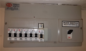

Hi,
I’ve just had an EICR done last week, One item I do not understand and would need an electrician or someone to help please. the EICR report says “MISSING TRUNKING WITH WIRES NOT SUPPORTED C2 SHED.” The cable is clipped on the wood wall in the shed. There are no exposed wires. And the shed is not on escape routes. Does cable need to be in trunking in order to comply with the electrical wire regulation? Is the code 2 correct for this situation?  please see photo.1ff9527a633c65202618bef88f7b0919-original-shed.jpg
Thank you for help

    For  the umpteenth time, the cable is not secured in any way whatsoever, it is not good enough.
  • Yes, it is not good enough, it needs fixing. C3. Open end etc. C1.

  • Sparkingchip:
    There are very good reason why I don't do electrical work without inspecting the consumer unit and intake equipment first.
    Yes, potentially dangerous. No R.C.D.
    Z.
  • Zoomup:
    I'd be more concerned by that exposed terminal. Difficult to see whether it is sufficiently recessed to be IP2X!
  • Chris Pearson:
    Zoomup:
    Recessed?
    The body of the  MCB is in front of the enclosure.
    Yet, the house was rented out in that condition.
